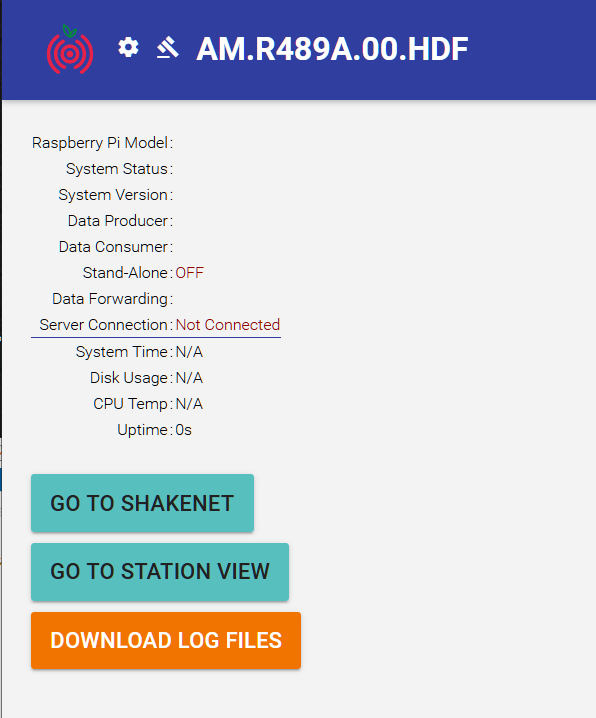

Any news? It is even getting worse and the mainpage is missing also values.

After investigating the logs, it seems this is related to bad values in /opt/settings/config/config.json, specifically lat and lon. Can you confirm they are not null and if so fill in a value for them ( 0 is fine ).

Hi wlee
Thanks, that solved my “Empty Main Page” problem, Server Connection: not connected.

On the main page, Server Connection is still not connected.

My Boom is still on 0.16 showing Server connection: not connected. Does this disturb the auto update process?
