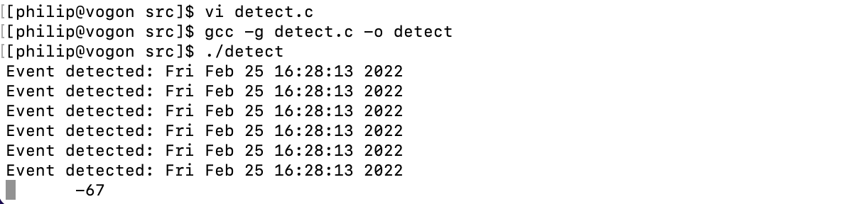

mejocama,
I know you said that you are no longer a programmer … I think I can say that I pretty much fall into that category myself. It has been many years since I sat down and wrote real code.
But I got to wondering how hard/easy it might be to code something to use the udp data stream that is very easy to configure, and is used by RSUDP - which I did get running, but it really wasn’t that easy … different story (if you know python and anaconda it is probably trivial).
So I set up a second udp stream to my Linux system and wrote a bit of C code to grab the data.
I just extracted the count values, and calculated a rolling average over a window of 250 samples (10 seconds) - very trivial algorithm, not a real rolling average, but it works for my purposes.
Wait for 1000 samples to give the average time to stabilize, then subtract the current average from each data value as it arrives, this gives a small delta value, deviation from that average. Take the ABS value of that, so we are only dealing with positive numbers, and if the deviation is more than some value (I used 1,000) print a message.
Does it work? Well, here is the thing running:
(The -67 at the bottom is a bit of diagnostic output, printing the delta from the average of each value.)

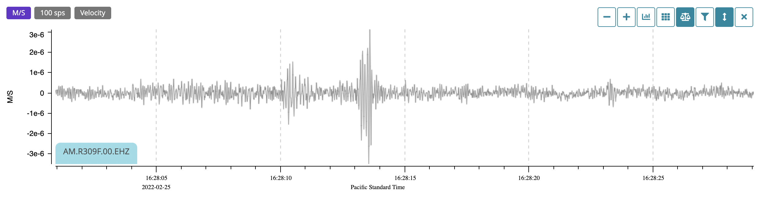

So we had a burst of values with a delta of >1000 … was it real?
Yes, there was something happened there. Times agree.

Well, probably calculate a rolling average with a small “window” and use that for comparison to the long term average to avoid triggering on single, random spikes, and probably a “dead” period after triggering to avoid a lot of output for a single event. Then add code to execute an arbitrary executable when it triggers - eg a script to send an email.
Could this run on the device itself? Yes, I think so. I probably wouldn’t do that … one other thing to consider is that the OS has been stripped down for reliability etc., so there is no email support.
For what it is worth, this is the code:
