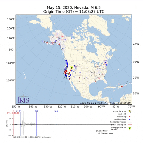

If you take a look at the earthquake ‘wave’ motion here:
You can see how many sensors (keep an eye on Alaska up north) allow the pre-shake system to ‘see it coming’.
One sensor on its own, it will alert at the exact time you also feel it.

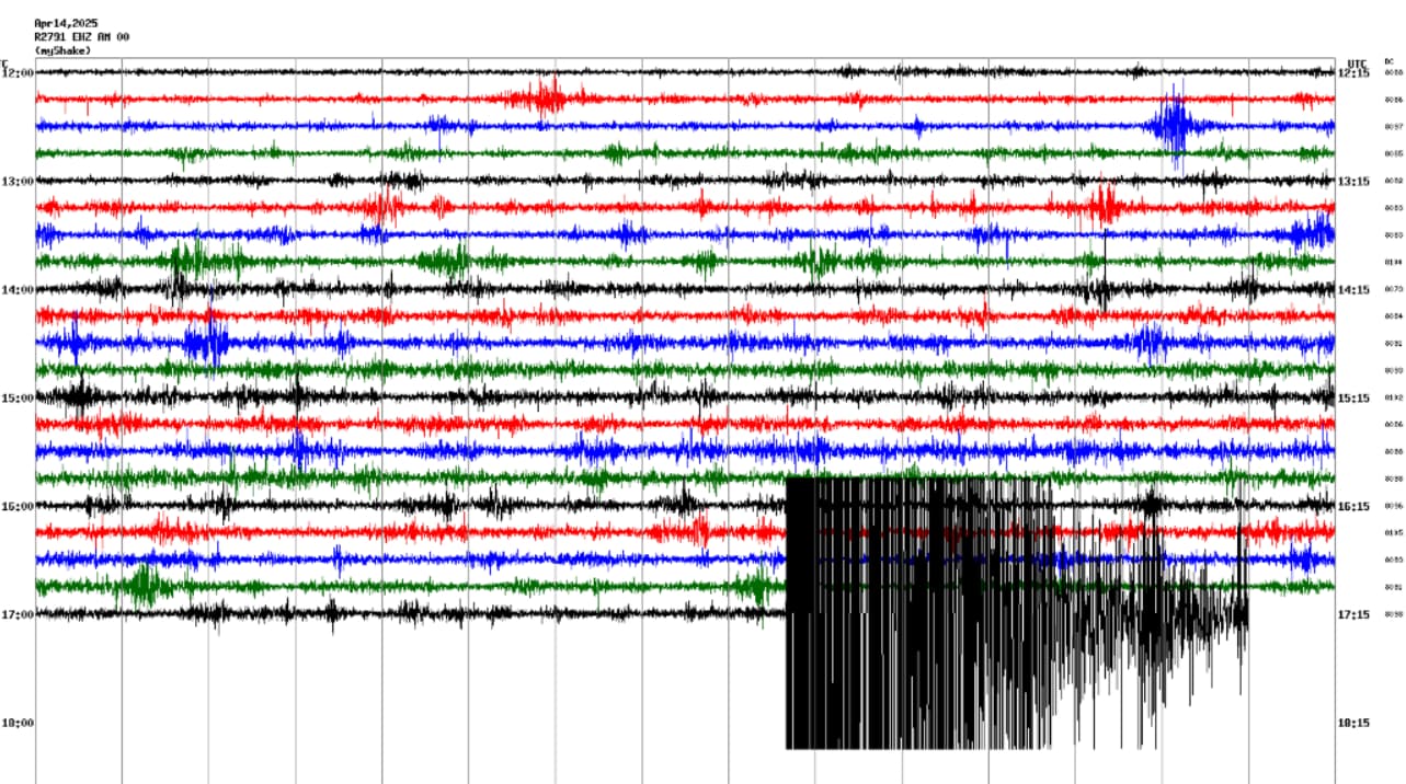

This is a typical heliostat trace from my RS4D. You can see how things are fine, then bang, the earth slips and the quake starts. No pre-warning possible from a single unit.
