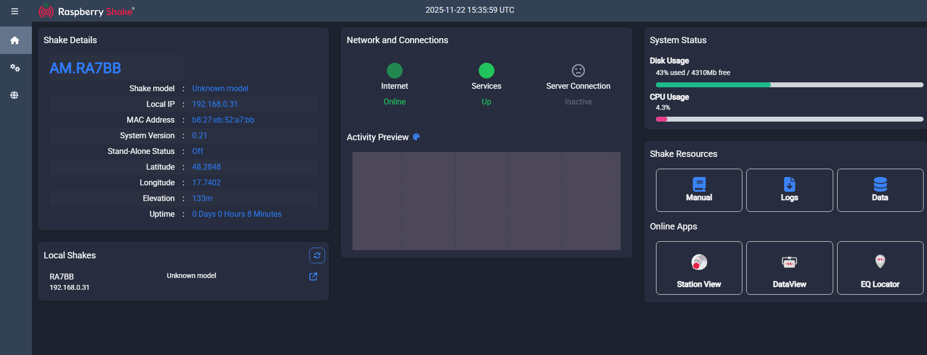

After update i don't see model, i have (1D), Server Connection Inactive
After update i dont see model, i have (1D), Server Connection Inactive, blue diod is active, red is active, green is flashing

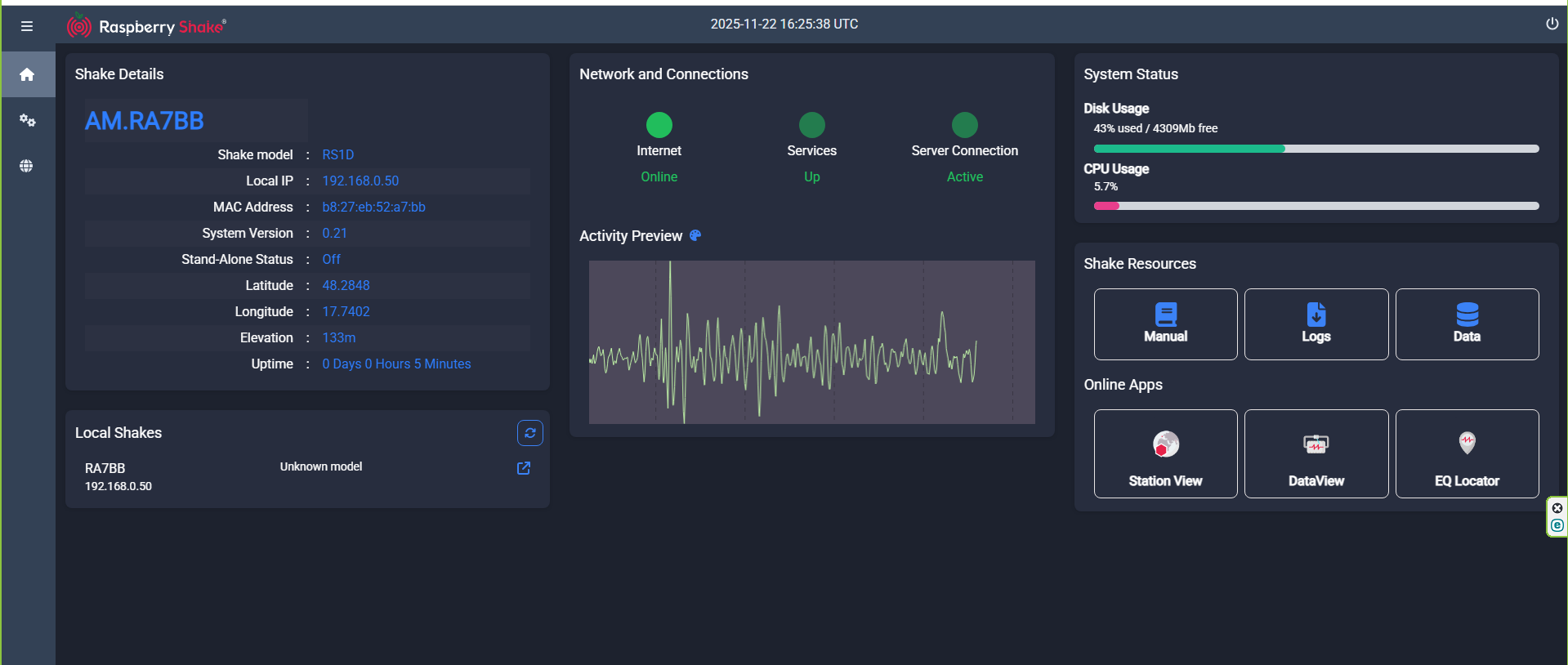

thank you now is all OK :slight_smile: I use command line with your codes to solve
echo ‘AM’ >/opt/settings/sys/NET.txt
echo ‘00’ >/opt/settings/sys/LOC.txt
sudo reboot
