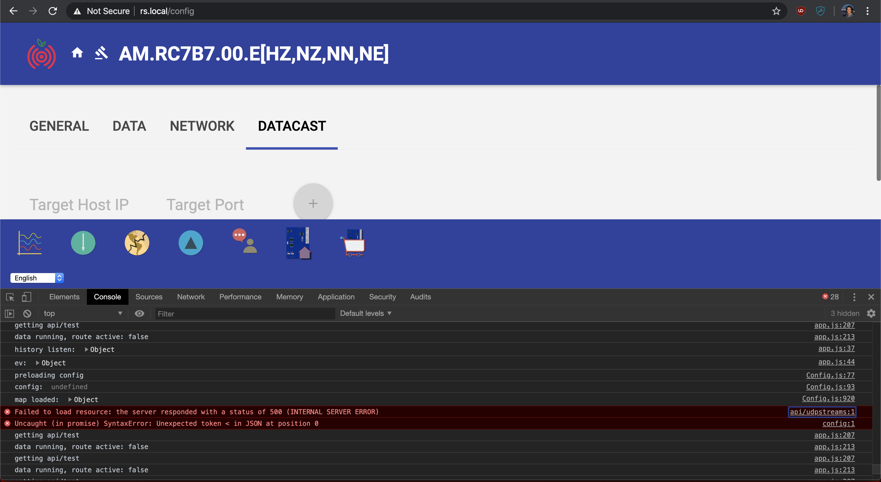

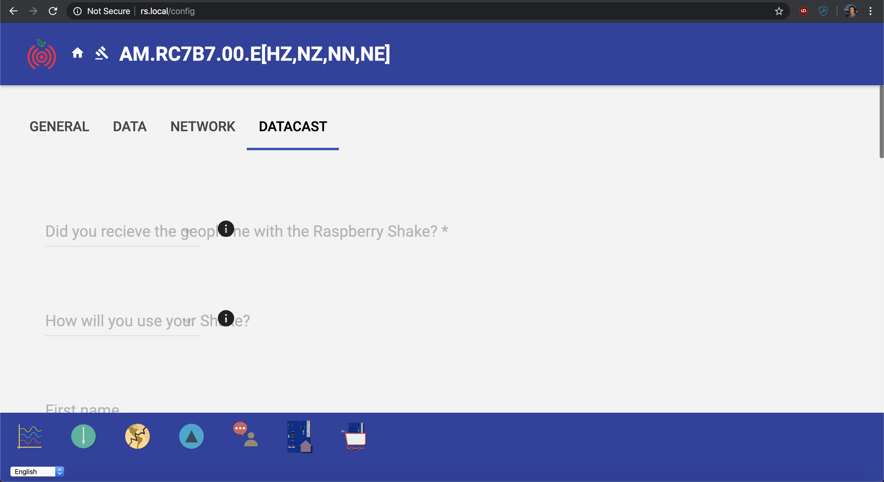

When adding a new target server/port on UI it breaks the interface. Note that when the UI tried to pull a list of datacast entries before I added a new server, it was returning a 500 error. Screenshots and logs attached.

This appears to be caused by a missing UDP streams conf file as per this log snippet:
