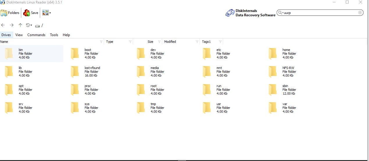

@iannesbitt I only have Windows 10 Pro, I have DiskInternals Linux Reader heres a screenshot can’t find /opt/log

I’m looking via DiskInternals here is a screenshot of all the foldersHi @QC91, in that screenshot, shadow would be in the etc folder.
