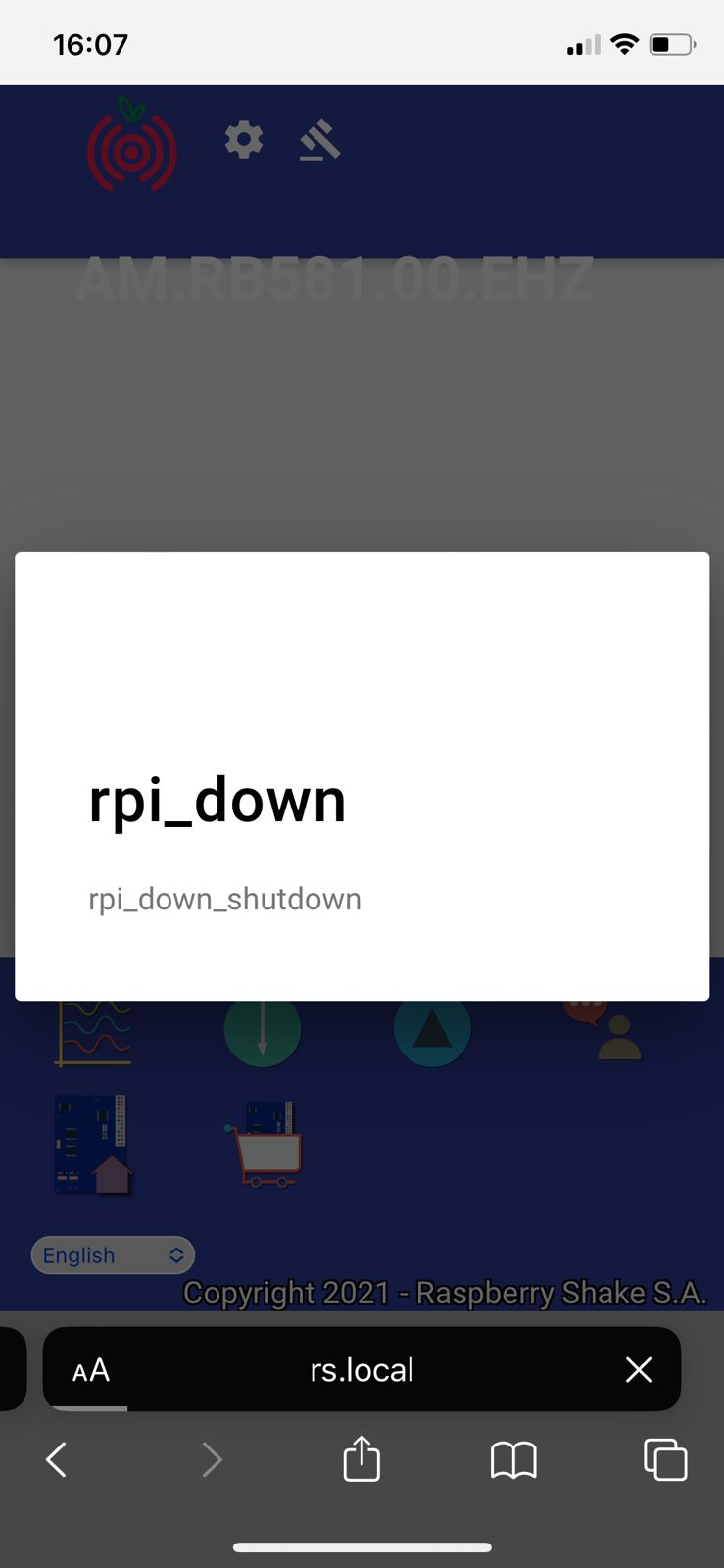

This afternoon I was making some changes to the configuration of my RS1D (AM.RB581), through my cell phone, the Google page was very slow and when I tried to restart it, the page showed me an “rpi_down” ad.
It stuck for a long time, and I had to unplug the RS from the outlet. Then I connected it again hoping to have solved the error, until finally after several minutes the signal from the seismic record came back, I saw it from ShakeNet but the configuration page still did not load.

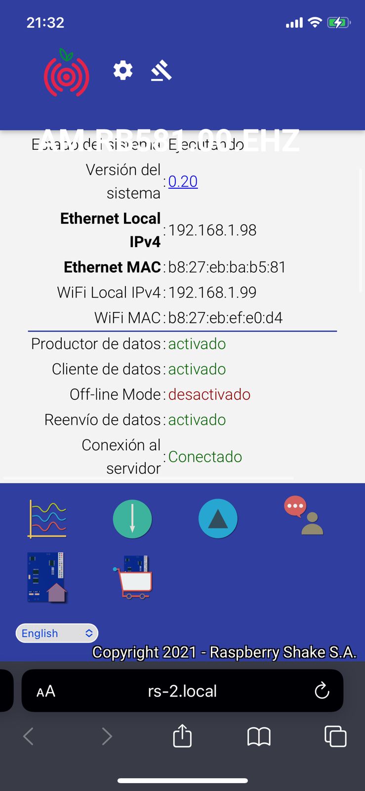

I disconnected it and hours later I took it home to try to access the configuration from my laptop, I connected the RS to Ethernet and the configuration page took a long time to load, but I finally accessed it and it connected to the server.
It is currently working properly, but I am concerned about the state of the hardware.

The rpi_down message appears when you shut the Shake down completely, or, in your case, while the Shake was down in the process of rebooting itself.
To get the signal back after a reboot can usually take up to 3-5 minutes (at the latest), so if it took longer than that, there could have been other issues. I have seen the power disconnection in the log files (thank you for posting them, together with all the details) and the following Shake start up, and the instrument now transmitting data.
