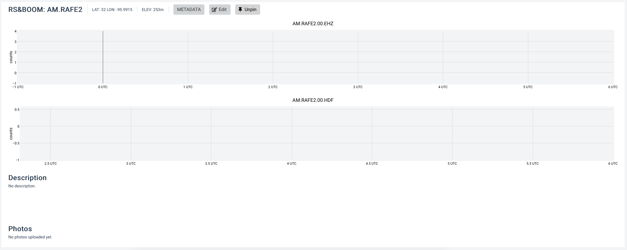

Please provide a record or let me know how I can monitor activity for today 8/10/2021. There was a ground vibration at 11:04 cst. I should have been able to capture the shake. But, my screen shows no activity.
Hello Mountains703,
From our new DataView portal you can see that between 23:40UTC yesterday and 19:40UTC today, something prevented the Shake data transmission to our servers:
https://dataview.raspberryshake.org/#/AM/RAFE2/00/EHZ?streaming=on
The data is however still saved on the Shake itself (unless the data flow was stopped due to a power cut), and you can access it by using a software called SWARM, which is free and that you can download from here: USGS: Volcano Hazards Program or that you can download directly from the rs.local/ page.
