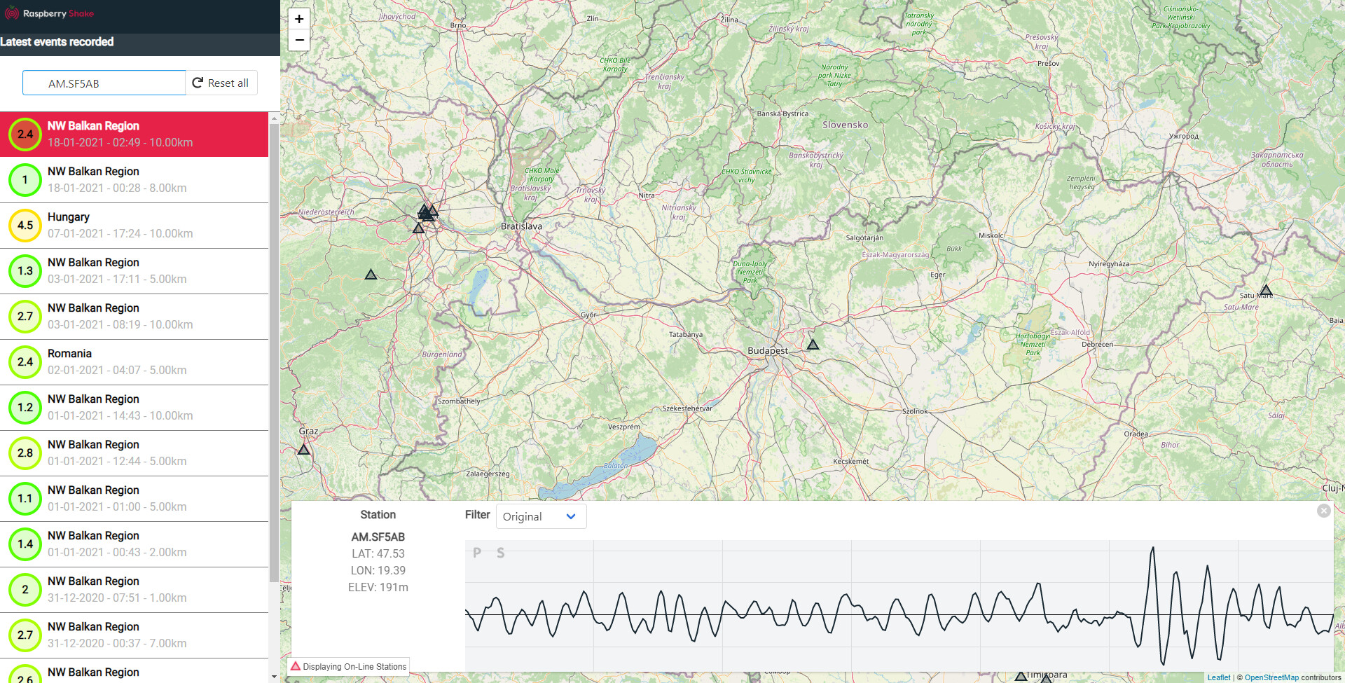

I’m new here, get today my brand new RS1D (station AM.SF5AB in Hungary). I hooked it up, its working, calibrated, and is online. Server connection is Connected, Data Producer and Data Consumer is ON. My station is visible, but not on all sites. What i mean, and what’s not clear to me:
https://locator.raspberryshake.org/
My station can see on the map, but when i click on my station, it says “No data found” and the lover status is empty. Why is it empty?

I tried your Shake AM.SF5AB with an M2.4 event (the first of the list) and I can see the data on the bottom of the chart. It was probably empty when you checked because the stream was still being organised, and thus, momentarily not available.
