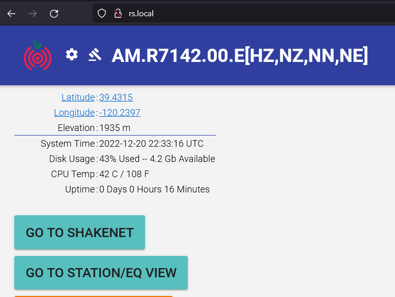

At this point we haven’t been able to access the rs.local page through its IP and thus can’t download the log files. It seems that we can’t give much more info without that access…
My Shake and DataView don’t show it as disconnected but no data is streaming.

Today we were able to connect to it with a crossover cable, but it continues to drop the connection (for example twice in five minutes). At one point we were able to download the attached .tar file, hopefully its helpful. The usual rs/local page didn’t have the option to download the logs:
