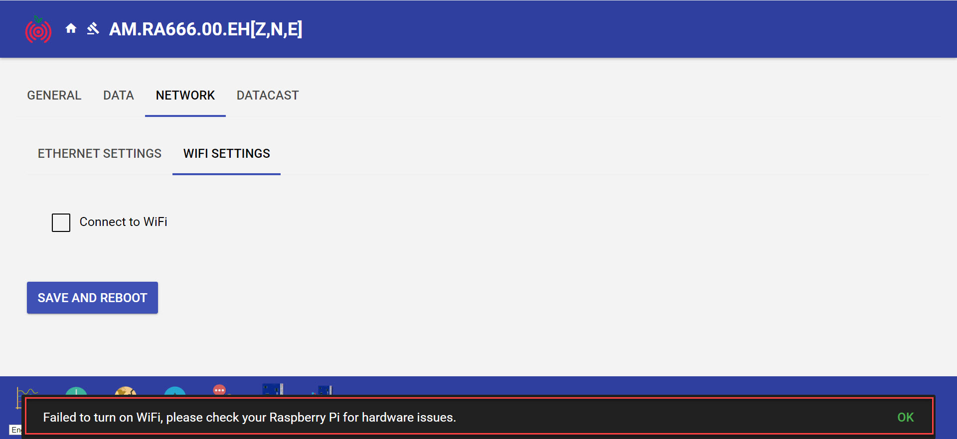

I have been trying to learn different networking settings in Raspberry shake 3D. It has been working fine. I tried standalone mode it was fine then switched off standalone OK.
The problem started when I connected RS to by wifi network and got the message - failed to turn on wifi, please check your raspberry pi for hardware issues.
I tried to go back and connect via Ethernet and now it i cannot access the web interface (rs.local) at all. Attached is the last log before web interface disconnected. RSH.RA666.2020-04-06T05_56_13.logs.tar (2.0 MB)
Please help on way forward.
Thanks
James
hi james,
for the log files you provided:
  • it appears you have connected the Shake to your computer directly, which would explain why the rs.local URL won’t work. to fix this:
    • re-connect your unit directly to your LAN router
    • if rs.local continues to not resolve, find the IP address of the Shake using the app FING (or equivalent) and then specify the IP address directly in your browser address field
  • Stand-Alone Mode is also ON, which will, by definition, prevent the unit from connecting to the server, or from invoking the NTP daemon to keep your Pi’s clock synced properly to internet time servers. this can, and should, be turned OFF in the ACTIONS::ACTIONS page of the front-end configuration program.
